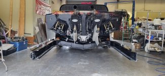

“I did the set-up work to make the wrap fit on the boat and printed out the designs. Adam Williams, a freelancer with 20 years of experience took over from there. He literally did the installation at Phantom as they were rigging it the last three weeks before Key West. We did bits and pieces as they had it ready, first the deck, and then when it came to the sides, they weren’t smooth enough, or more glass work needed to be done… it was crazy. They wanted to know if we could wrap while the engine hatch was up,” laughs Ryan.
The design was born in Key West and that’s where the boat returned for the ultimate test at the 2023 Key West Worlds, which ended with an overall second place silver triumph. Throttleman Richard Davis explains how the three days of racing went, “It was a brand new boat and we only had two days to dial it in with water pressure, props, etc. We really needed a week. We took a gamble by using the hoses from the Cigarette. We adjusted the water pickups as much as we could, but ended up blowing two hoses.”
“The top hose clamp broke and the bottom clamp couldn’t keep the hose on the fitting for the sea strainer. We fixed that one and put four clamps on. Then, since each motor has its own pickup, on Sunday, the hose coming from the pickup to the other motor to the sea strainer split. For next season, we’ll be changing to hydraulic hoses with fittings that screw onto the sea strainer and the pickups," notes Richard.
