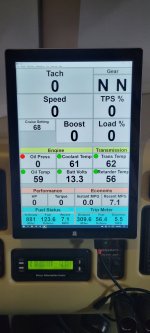

My FIL had the Bluefire and has since switched to the Silverleaf VMSpc, which is what I have. I won't even start my engine without it being online.
https://silverleafelectronics.com//?page_id=2434
This runs on Windows through USB, so I bought a Microsoft Surface Pro 4 and used 3 of the Scosche MagicMount Pro units to hold it in place. The old headunit for the Javelina monitoring system was a single DIN size, so I bought a cavity mount and made a face plate and glued them on. Install thread: https://www.foreforums.com/index.php?topic=42574

That’s a really clean setup. I’m not biased to any platform windows vs Apple but everything I have is Apple is the silver leaf compatible with it? What made you go from BlueFire to silver leaf? The thing that appealed a lot to me was the price point of the BlueFire. What was the damage for the silver leaf?
VMSpc will only run on PC "Windows" computers, so no Apple. It's not Android compatible either, like Bluefire is. My FIL had many communication issues with the Bluefire. He would have glitchy data, and sometimes no data at all. Since switching to the VMSpc, no more issues.
I paid $399 for the VMSpc stuff, and bought the computer separately, used off Craigslist.
