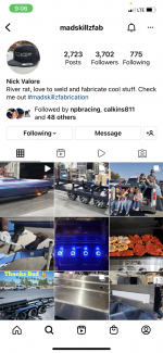

So Hardin is 6 weeks out on the dual engine split foot pedal. Anyone out there have any tricks or pictures for making a regular foot pedal work with two merc cables?
Ck out MSF on insta. He could probably modify or make you one easily
