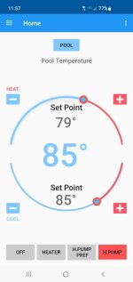

Anyone have a Pentair heat pump/chiller ?
I am trying to get some info on how to change the "cool set point"
The Panel is a Pentair PL4/PSL4
Anyone have this set up ?

Do you have the app.? It's pretty easy.
Yes in the app I can do it.
My issue is that my pool Cool setting is set to 100 and think I believe it needs to changed on the panel.

I have one thats 5ish years old.
If you select a temp 3 degrees below current water temp it goes into cool mode.
Melloyellovector
Jun 4, 2014
3,892
8,438
Everything you do on outdoor panel can be done on indoor panel and or phone
on the ap to adjust temp you should just drag finger over the temp setting and move to desired heat/cool set points. And done
unless in settings you removed ultra temp and defaulted to master temp / heater
edit: if you only have ap base on phone or tablet for control only then there’s another ap you can download for programming.
otherwise on outdoor panel, see above
I'm thinking this was the case when they set it up. When the water is say 92 and I set to 88 it just keeps flipping off because the set point is at 100 and that can't be change ( to my knowledge ) on the app. I don't have an indoor panel , just the app and a little box that is hooked to my router.
I will play with it today and see.
Thank you !

Ha ha ha, I've been through this. I feel your pain. I've spent hours with this crap.
It's a glitch in the screen logic software. They refuse to make a software change to combat the problem. I've talked to Pentair and gone on some of the message board forums.
Basically you have to change the settings using the SLConfig App to get the chiller to work, then to get your heater to work you have to change the settings in the SLConfig back. Total PITA.
It's a different APP than the screenlogic.
Send me a PM and I can walk you through it.

Yes, let me guess you set it at the cool temp you want and nothing happens, and then it just kicks back to 100 plus degrees on the cool setting next time you open the app
Some info in this thread
