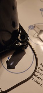

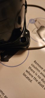

See if there are caps on the bottom where the holes are? I haven't put a new filter in this one yet. I bet there is a cap on the end that needs to be removed.
4 "ports" 2 at each end....2 males and 2 females....all have o rings
Gramps
Older Member
Sep 24, 2007
9,125
13,103
This is the new one....the old one won't go back in

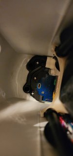

Is the grey lever in the middle holding it up? Like it needs to be pulled back for the lip to slide down in?

In the last pic, is there any way the receiver could have become dislodged, like partially stuck when removing the first one? Maybe they aren't aligning?

Going a little off camber here. Could you put a coat of chapstick where the 4 ports are, and test fit it? Not to lube it, but to see if possibly the lower tube are shifted. It will leave a mark, and you could see where they need to go. I see the ones deep down appear to have alignment deals in the plastic. I wonder if the others have twisted slightly due to heat or age.
Gramps
Older Member
Sep 24, 2007
9,125
13,103
just tried that.....it appears everything is aligned.....there is something preventing the filter from going the last 1/8" ..the filter stops right before it engages the ports and a gentle push you can feel them engaging into the ports ....reaching into the unit with a stick everything looks and feels solid.
Gramps
Older Member
Sep 24, 2007
9,125
13,103
and the rest of the story..............I sent a shitty email to Inogen, it landed in the right hands and I got a call with the fix. This whole mess was somewhat my fault. The filter is black, the connection deep inside the unitis black. The instructions say to take off the dust caps, there are 2 BIG gray dust caps that are easy to see...........now the problem. At the other end of the filter there is 2 small nipples (black) that plug into the bowels of the unit. Those have a "sleeve" on them. I did not see the sleeves and when I slid the filter into the machine the sleeves came off and got stuck in the ports. When you look inside the machine it looks like they are part of the machine...................Customer Care at Inogen tells me this happens very often. My thoughts are, make the sleeves more visible, like the other two sleeves are.
