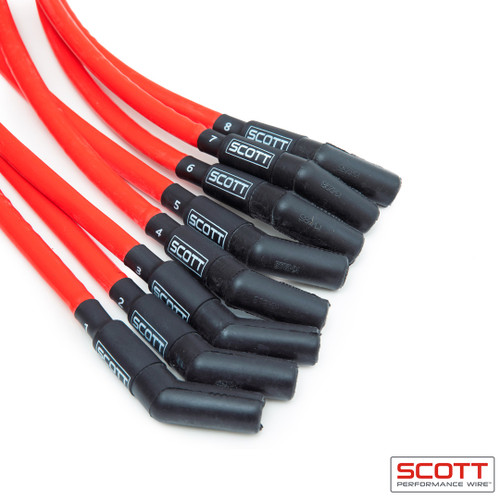

Posting these just in case someone else is looking….Thanks again.
Shlbyntro
Ultra Conservative
May 27, 2018
7,744
22,587
I don't think those will work. the factory wires have 2 sizes. short for the outer spark plugs and long for the inner spark plugs
here, these will work
UnWoke
Jun 6, 2023
79
30
I just noticed that myself…they are all only 13” long.
I think the set on the boat are 24” and some even longer
Shlbyntro
Ultra Conservative
May 27, 2018
7,744
22,587
WTF is the difference between those and these? That’s just crazy.
The brand. Merc is crazy expensive as well, something like $80/wire. The ones I posted are standard run of the mill wires. Sierra makes a great performance after market set for fair money. I'll see if I can get you the PN and post below

And WHY I brought up about the boots for the 496 s wires. This pic below KNOCKED OUT the ign coil driver in the PCM 555. Why the boots are so important and this is coming from a guy whom inspects , tests , repairs and even remans marine ecms EVERYDAY for a living. I know what they hate and fails them. ------- the boot was under side shorting out against the valve cover so it was hidden and failed the ecm in short order ... The white tells the story as well ( big arcing ). Buy quality wires and change them more than you would ever think so for marine apps.
Lavey 29
May 14, 2016
206
106
All of the wires posted are meh at best. Here is a much higher quality set for less.
They did not even get the PIC right for the 496 wires - the ign coil boots in their pic will not even work period for the 496 coils - I guess they know zero about the marine 496 s if they can not get the pic right to begin with. Just saying
Glad to help them out when this post gets back to Scotts. Lets see how fast they change their pic
Many products sold don't have the actual pic posted.
