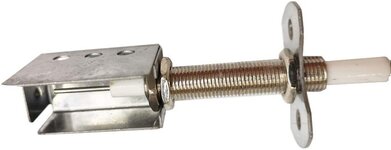

A couple weeks of rabbit holing and I ordered a bunch of parts and pieces!
A little drilling, taping, and pipe doping and I have burners, gas valves and WIFI
I started with some burner jets from a turkey fryer burner, built a little test manifold and drilled out the orifice with different size bits, not very scientific but it worked
I built 2 large burners and one small burner
Mounted the gas valve and WIFI board for gas valves and ingitors
WIFI board and a 12 volt to 9 volt regulator to power the igniter modules
Finished product all controlled from my phone

Not too well versed at all the WIFI "devices?" All of this runs off a 12VDC system, I found some 12vdc relay boards that operated off the "TUYA SMART HOME APP". Its compatible with google assistant and google home (I think??) thats the next step, move it to google home for access anywhere, (I think??) The literature made it sound way too easy and i could actually follow along with the instructions. I mounted my lighting control and these in SS enclosures which required external antennas. That narrowed the options of boards i could find. I have a bunch of 120V (TUYA) modules I am going to try and do my garage doors, gates, the exterior house soffit lighting, my christmas light outlets and whatever else I think of! It has been fun trying to figure it out, and the satisfaction when it worked was worth a few beers.
You can barely see the IPX1 jack for the antenna
