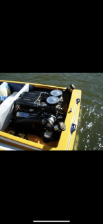

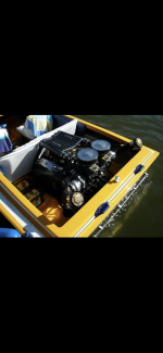

Surfing the web I came across this 22’ Schiada with a draw through single carb twin turbo system. Who might of built this and was there too much heat pushed through the intake without an intercooler? Im assuming it was a low boost system, maybe 5-7psi.

There were a few shops that built systems like that. Banks and PFM are a couple. It looks to me like there is water to the plenum on the manifold. I would guess 5-7 psi of boost as well and typically regulated by holes in the exhaust snail housing

That's not a Banks deal, his name is not on it. I believe their is a single radiator in that box, Banks made some very similar to that. He also had just a small water cooled box that bolted onto the intake manifold with a few fins inside to help with heat. Difficult to tell exactly what's there and how it's plumbed. That line in the front is really too small to be water, looks like there could be a large one in the back, and possibly removable cover in the rear also. I would suggest finding water cooled exhaust housings for an engine that would be under the hatch.

First picture has a -8 or -10 going into a "T" just ahead of carb = may be water ro cooler🤷‍♂️

Tom Scahill set-up. Water in/outlets on removable rear cover as Barry mentioned. Uses a single Harrison Radiator core. Front was usually tapped for a boost/vaccum gauge and/or boost reference line and sometimes a second hole was tapped for a boost controlled Hobbs switch to engage a secondary electric fuel pump.
